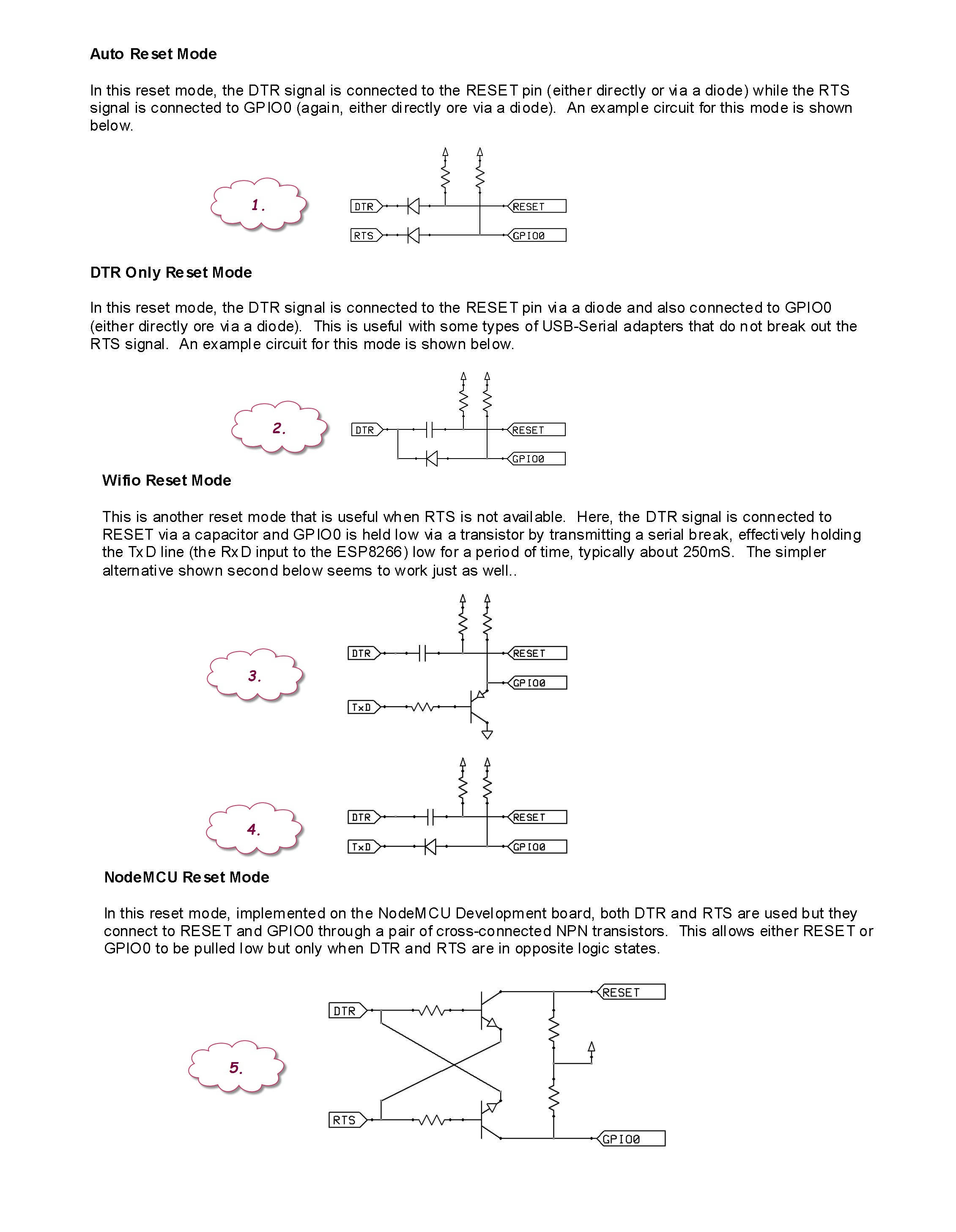

Following this image which is the best auto reset for ESP8266-01, if I use NON-OS 1.5.2 SDK?
Thanks.
