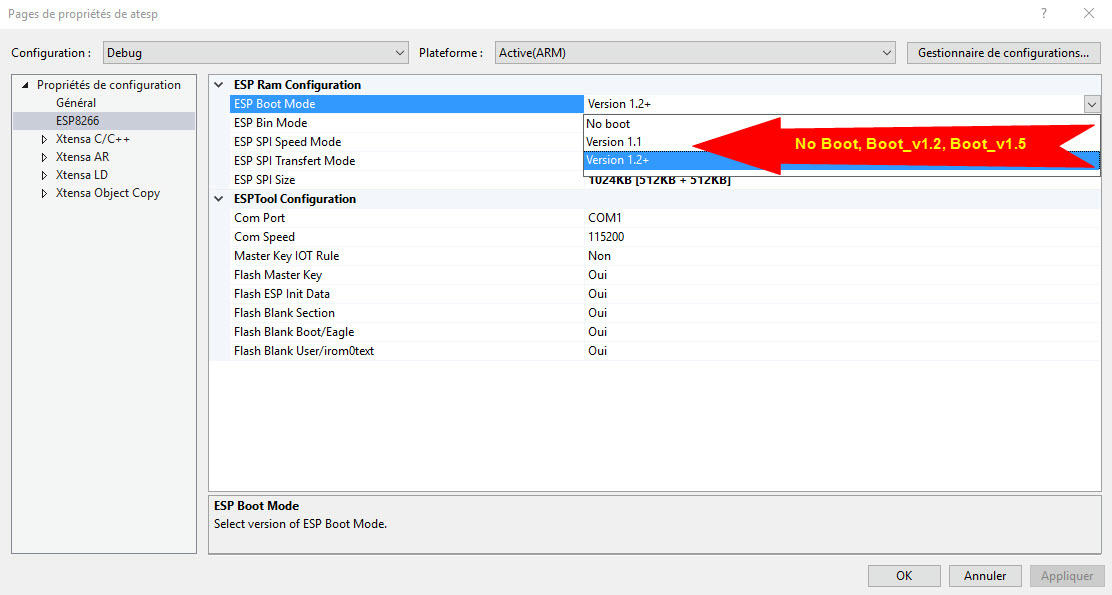

I create Visual Studio 2015 Plugins to compile ESP firmware (http://bbs.espressif.com/viewtopic.php?f=7&t=1867) and I fix some bug about "version selection" versus "Boot.bin version".

OK, if you choose boot_v1.1, it's gonna COMPILE with old file inside LD Folder. But when it's gonna be time to flash, it's where that I find a little weird. It's beautiful to COMPILE with old file, but we don't have Boot_v1.1.bin.
Now we face two possible problem:
[*]Programmer forget to update version string inside Gen_misc.bat
    "0=boot_v1.2, 1=boot_v1.4(b1), 2=none"
    "0=boot_v1.2, 1=boot_v1.5, 2=none"
[*]Old boot version is obsolete because we don't have proper boot binary file and programmer forget to remove from menu.
Thanks

Fleuve
Posts: 24
Joined: Wed Dec 09, 2015 1:16 pm
Re: Gen_misc.bat/.sh Version misunderstood??
Postby Fleuve » Wed Mar 16, 2016 8:02 pm
OK Thanks I will update my Visual Studio plugins.
That's mean "v1.2,v1.4,v1.5 = new" and "v1.1 = old" if really this... I gonna remove OLD concept from visual studio and replace FIRST STEP by a FILE SELECTION EX: None,boot_v1.2,boot_v1.5. Where ESPTool gonna take the proper bin file (without file compare to detect OLD and NEW version)
Or OLD Concept was:
on 1.5.0. Old = 1.2
New = 1.4(b1)
on 1.5.2. Old = 1.2
New = 1.5
