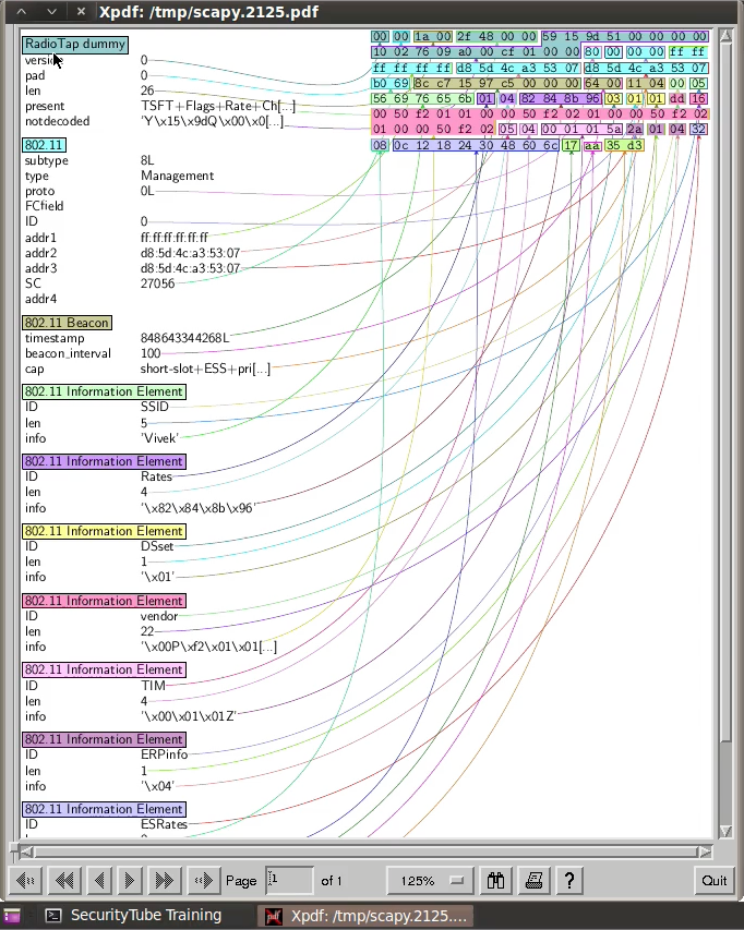

How do I get the 802.11 information element ?
Looking at a capture of the communication it looks like this
I can get the management request, the probe request (That gives me the 10 first chars of the SSID), and the Beacon without problems, but it seems like the the software is not listening on the Information Elements.
